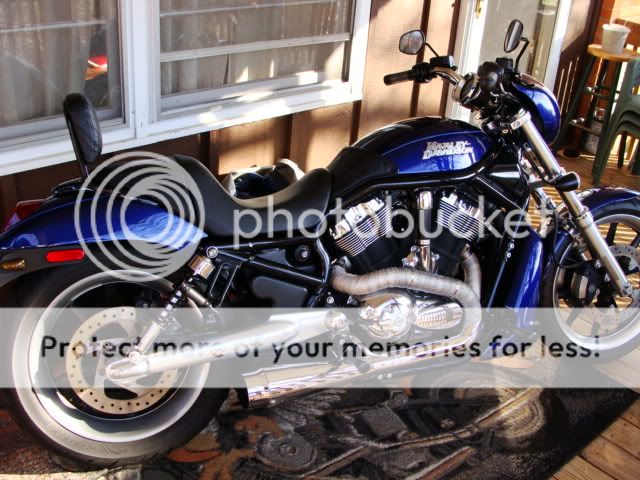

#14 ·
i think the wrap was about a year old when i took this picture. the black wrap fades pretty quick.
i had a chrome CFR megaphone i got from a forum member with stock header pipes.

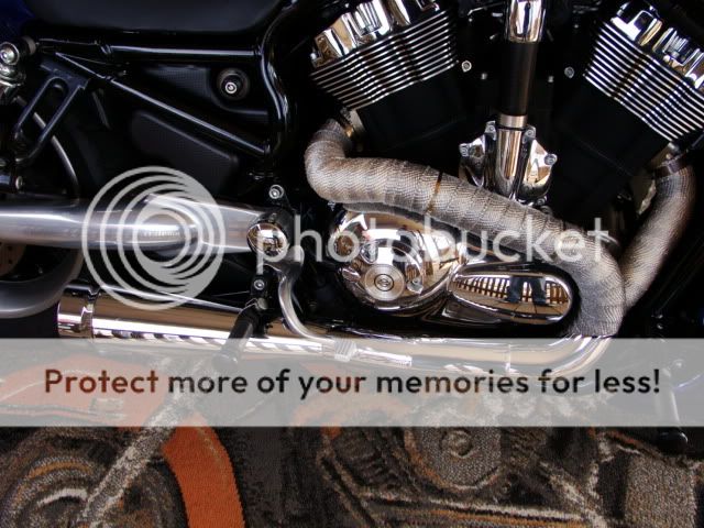

#15 ·
Vance and Hines 2 to 1 competition with DEI Titanium wrap. I covered the o2 sensor plugs on the front head pipe with the wrap, hasn't caused any issues thus far. As previously posted, you will want to wrap it tight. And for the titanium wrap in particular pull it straight and evenly, because if you pull only one side or pull it to the side it unravels REALLY quickly.
