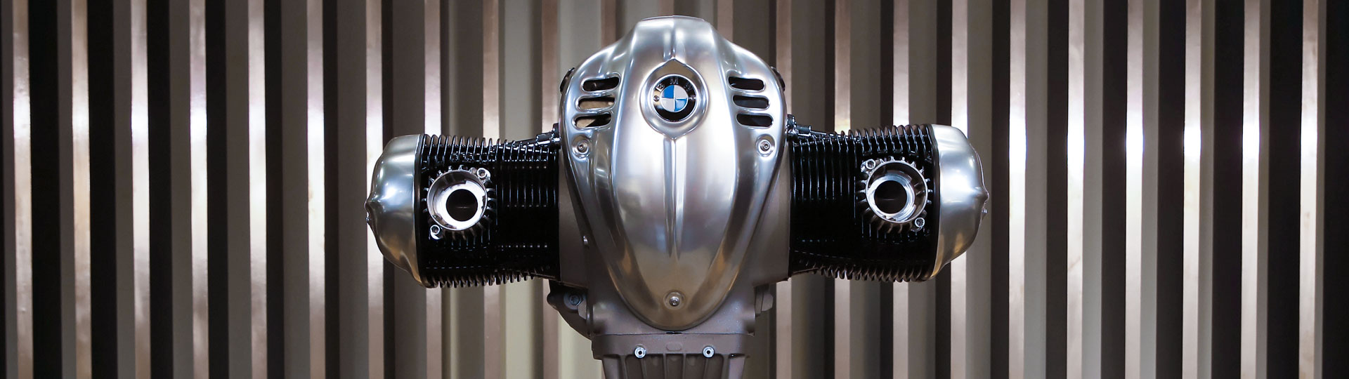

Hello streetrodracer,
as far as I know, the BMW boxer engines for example use NiCaSil- coating since the early 1980's.
And they are extremely reliable.
Also the newest member of the boxer engines uses this coating, see here in the 2nd paragraph:
