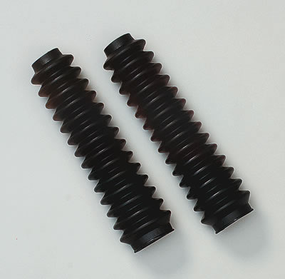

these daystar's i ordered look pretty good. just came - they seem big, but i dont have my bike here to check it out/compare. i think they're the ones in the photo above but can't be sure.

Wait... isn't that upside down?

i think i got the wrong ones, upon closer inspection. will try some others from daystar.

the other two styles should be en route. i'm pretty sure the ones pictured above are the right one - but that those are not Daystar 408, rather i think they are 381 series. we will see soon enough.
