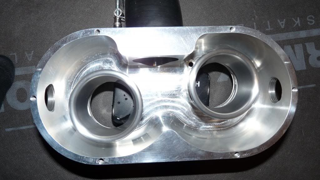

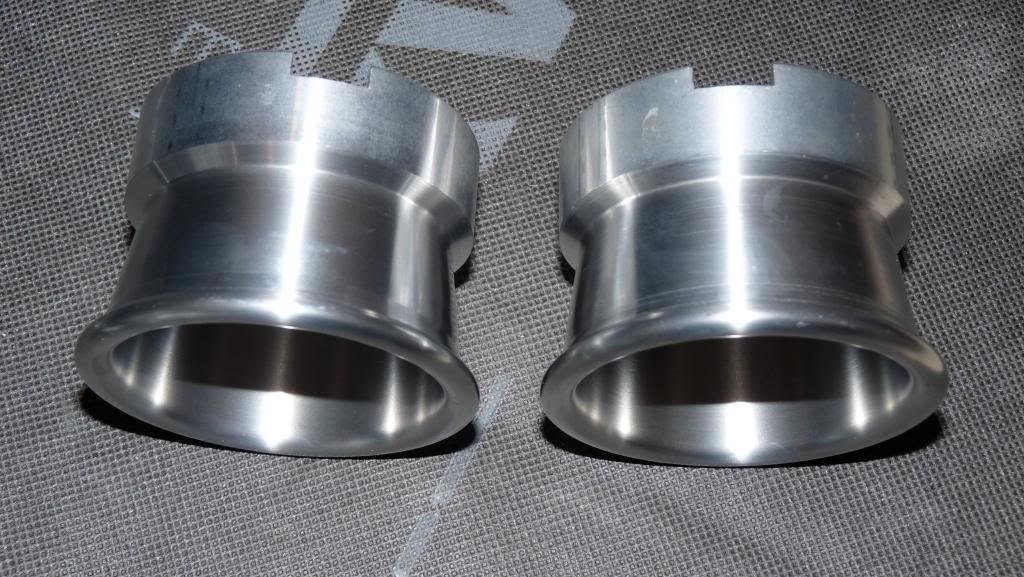

I machined a second edition of plenum velocity stacks.
They are 3mm shorter and 14 mm narow than the original ones.
Will go to a flow bench to test is the modification effecting something or not.
· '04 1300
3,073 Posts
Just looking at that plenum again makes me want a turbo, just so I can use that plenum. It's a complete work of art.

· Premium Member
3 Posts
I was fortunate enough to get one of Kazza's and Muckle's plenums and I can say that this plenum is one of the best engineered pieces I've ever seen anyone make.
Comparing it to one that was supplied with my initial turbo kit would be an insult to the plenum itself. My bike wasnt removed from the dyno or changed in any way except the plenum and the cold side pipe to suit and it made more power before it even started coming on boost, it in turn came on boost harder and faster to the point i had to re program the boost controller before i could do a power run. On a pound less boost it matched the peak power of original plenum. at same boost it made 12 rwhp more.
Very impressed with it.

Karzza,
Did you flow test the shorter fluts?
