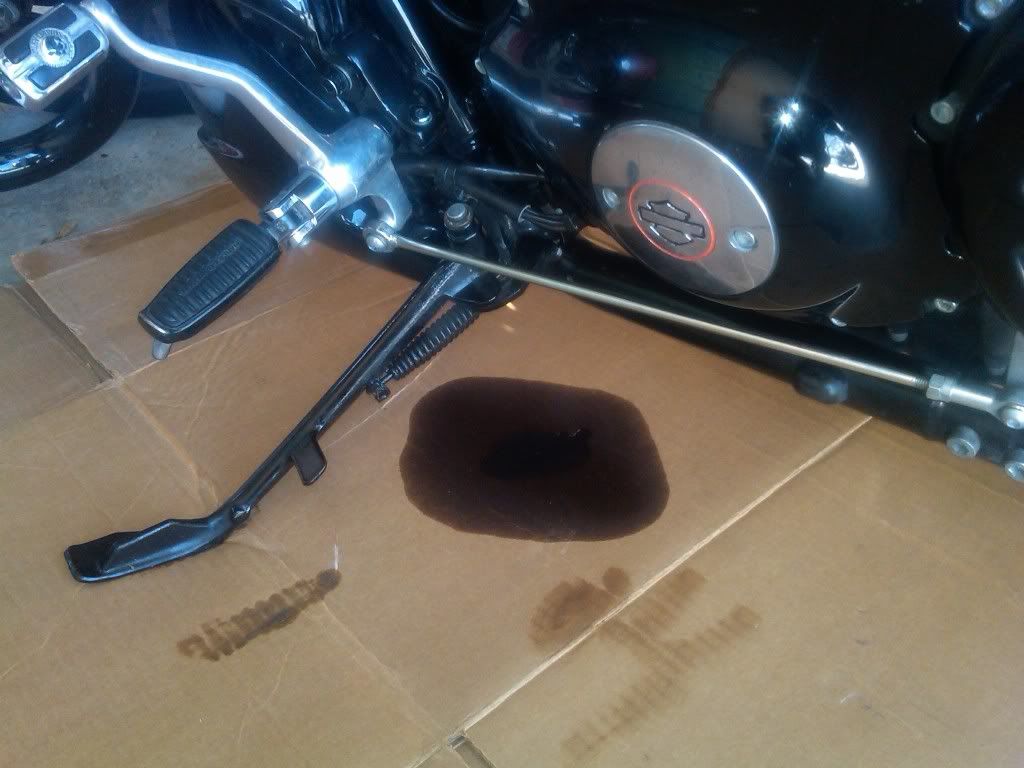

Howdy all,
Looking for advice as to how to fix an oil leak on my V-Rod. I'm not familiar with the parts that the pictures reveal (please see below). This is the first oil leak I've had since owning the bike. Have approximately 30,000 miles and the last oil used was Rotella 15W40. Prior to this I used HD Screamin' Eagle from which no oil leaks occurred.
Any suggestions or advice would be greatly appreciated.
Thanks.
3,516 Posts
Looks like it is coming from the stator wires? Could just be the gromet. Was not that unheard of on the pre 04's, but I have not heard of it on the 07. Try pulling off the cover and using RTV. There was another thread were a guy put a grommet in to stop his. I will see if I can find it.

What's up everyone? First, thank you all for the replies. After taking the clutch case off it was no surprise to find the grommet had slowly detached itself from the clutch case thus causing oil to seep through onto the stator wires. I waited for warmer weather and when the oil was more rigid to clean everything off. I applied RTV to the grommet and waited roughly 24 hours to settle in. Rode the bike roughly 200 miles these past few days and no oil leaks whatsoever. Cheers guys!
