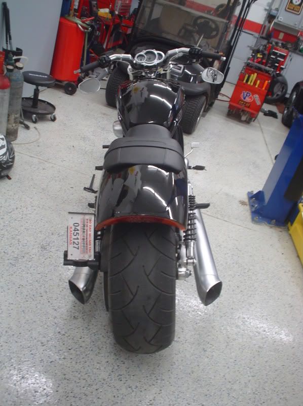

Got around to flipping my mirrors tonight, took about an hour to do. Also why i was there i turned my grip forward a bit (mine were kinda tilted up and felt weird). Pretty easy to do if you can solder, i just cut the wires about the middle, pulled off the mirrors and swapped sides. Soldered the wires and used shrink tubing to keep it stock looking. Funny how much difference it makes, the front of the bike looks lower (illusion of course) and i can see behind me better for sure. FUNNY thing i noticed the hazard switch,,,,,,,didnt even know it had that!!!! i should really read the owners manual, lol. Be safe, paul

Can you actually see with those?
i think even better then the stock way. The stock way my shoulders and arms are in the way, this way i see almost down the side of the back end of the bike
1,038 Posts
Yup even 2 up I can see great with my Flipped mirrors. I found if you run them parallel to the Levers it gives you a bit better site lines then with the Grips

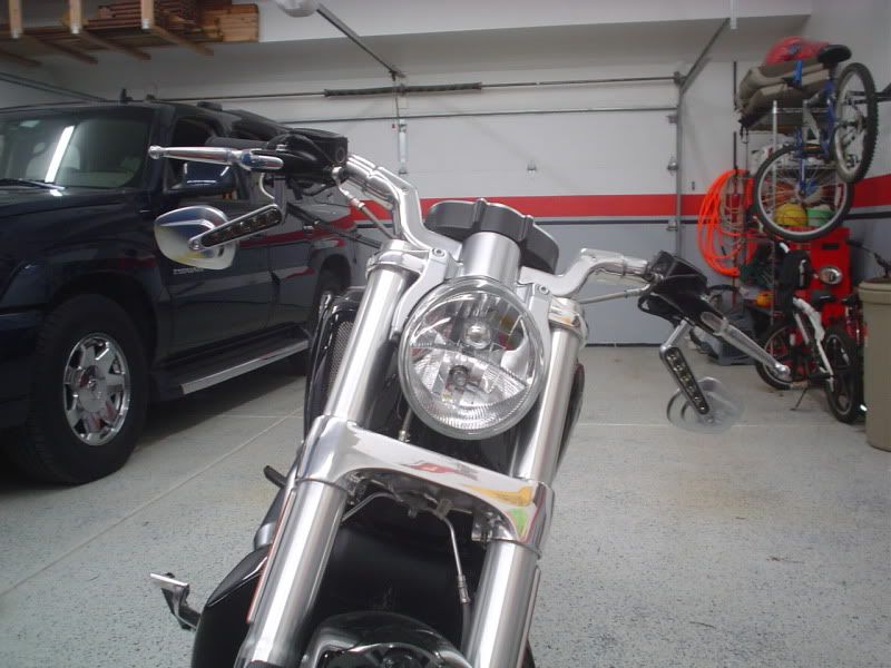

Hi everybody¡¡
I'm a new member of the mirror flip club, but i have done a little improvement.
I have drill the back side of the mirror support and i have hidden the wire avoiding drilling the top of the handlebar.
I have some pictures..
Doing this allows you to replace the original screw with a better one.

WOW thats awesome right there, i wanted to do something like that but a couldnt see how the mirror came apart, i assumed they were glued together but nto sure? either way thats a fantastic job bro!!!:notworth::notworth::notworth::notworth::notworth::notworth::notworth::notworth::notworth::notworth:

As you have guessed the screw is attached to the mirror bracket, I think with loctitte red. To loosen it i used a wrench like the one pictured, i don't know whow is it called in english.
Once you remove the screw you must drill the support to about 2cm from the base, very carefully to avoid damaging the wires, pull the wires through the new hole (I cut the cable and then went back to welding to make it easier) and reassemble everything.
