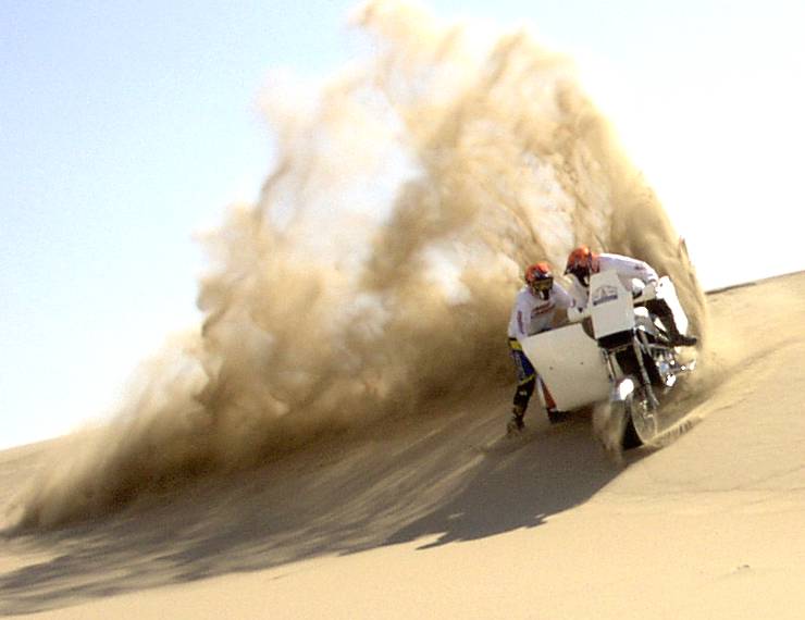

The two used engines Harley donated to my racing are supposedly from that batch of ~100. So far I've only run one of them, but it's pushing around 1200 pounds of men and machine through the nastiest terrain any V-Rod has ever been through. They told me there "may" be a problem with these two motors, but they would not tell me what the problem was. :confused: I found something (not to be divulged), and it would indeed reduce horsepower a bit. It was a fairly easy fix. Both motors had the same problem, which is now fixed. So far no problems with the motor in lots of off-road stress testing. :thumb: :thumb:
Hog Wild Racing
See less See more
Talk about taking a V-Rod where it's never been before! Great to see this engine holds it's own in environments it was never really designed to endure.
