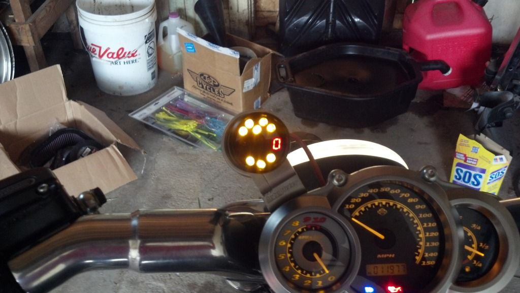

By request a few members wanted to see the shift light I ordered installed and in action. This is a light by Autometer part number 5343 Digital Pro Level 1. It has a single shift light setting, Max RPM recorder and 4 levels of light brightness 0-3 . Heres a few pics for your viewing enjoyment. 1st photo is just in "standby" 2nd is Level - 0 light setting and 3rd is Level 3 brightness!

Heres a few more pics of the Shift light. Install is very easy. Green wire to the #3 pin ECM, Hot Red & Ground Black.Yes I have some Green wire going into my Switch hot but the light comes with about 3ft more then you need on the Green wire. The Black & Red were a bit short. The light itself is about 2 1/16 in round and 5in long. Only NEGATIVE review I have is the wire has NO protective wrap (heat shrink) the whole lenght of the wiring so I added it myself, otherwise I love it!

No it doesn't have a launch setting. The Level 2 has a launch setting and a progressive shift point. The Level 3 has all the same but 90 seconds worth of playback. Even at a Level 1 light I love it! IMHO you won't be disappointed. Again only Negative on it is it doesnt come with protective covering on the wiring so make sure you got shrink tubing on hand

Quick question, did you just drill two holes into the gauge housing to mount that on there? I just got mine in today and want to put it on the bike tomorrow, just exploring possible mounting options. I really didnt want to drill in there to mount it, but I will if thats the best option.
Also, if you did drill it, does that piece just pull off so I can drill through it without damaging anythign else?
1,024 Posts
Discussion Starter #19
Yes I drilled right through the gauge housing. If I ever want to remove it all I need is rubber plugs that sit flush.. I don't know about other models BUT.. On the Muscle.. 2 caps head bolts hold the headlight assyembly in place. Take those 2 out and there is the plug for the speedo, unplug that. take the 4 button head bolts off the faceplate and lift the whole cluster right out. there is a small gab between the gauges and the housing (mine about a 1/8th) so you either have to get shorter bolts or I just used a dremmel with a cut off wheel
