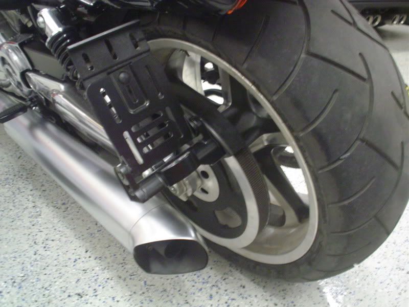

Took the stock plate bracket off and chopped a piece of it off. Then I drilled 2 small holes thru it and the belt cover and mounted up and down. Easy to do and free, the light wires will reach (just need to take off the back seat to get more slack out of it) so the stock light for the plate is still used. Easy job, regards, paul

Is the belt cover sturdy enough to hold the plate securely while riding? Looks good.
sure, the cover is metal and mounted rigid. the plate weighs maybe 6 oz. The belt or pully wont come in contact, there is about 3/8 inch between the gaurd and pulley. The bolts have really thin heads so no worries of inteference.
