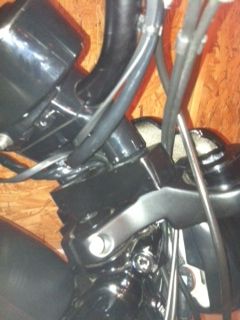

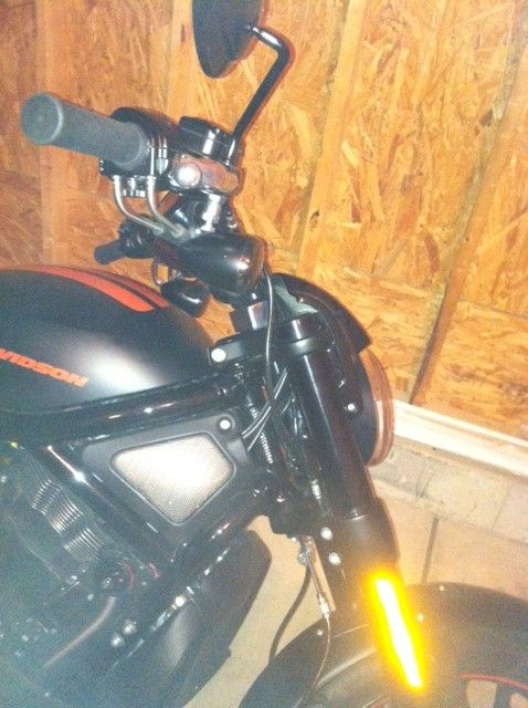

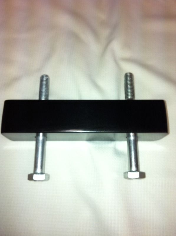

We're happy to announce that the DX riser project is off the ground and we are taking orders for them They will start shipping on Tuesday 10-16-12.We all love the vrods but Unfortunately we are all not the same height and it makes some of us shorter guys have to really reach,,,, or if you're like me my back just cant take reaching for the bars for very many miles. SO,,, here's the solution!!!!The risers are 1.25" thick and come with new longer handlebar bolts and are powder coated black to match most of the bikes (if you want them polished just let me know). The riser is very easy to install (watch the video below) and even for a novice you can get it done in under an hour. After the install you will notice instantly how bringing the bars back to you helps the ride quality.
We have sold over a hundred of them for the VRSCF style and have finished ironing out the measurements and details to make them for the DX. The only issue we came across is on some DX models the front brake hose after the riser is installed doesn't have enuf slack in it to make full turns one way, and the fix was really simple (10 minute job). Its as simple as taking 3 Torx bolts out of the master Cylinder, taking the MC off the handlebar and sliding it thru the forks which puts it now on the back of the forks instead of on the front and then reinstalling the MC. Simple ten minute job that is very easy even for a novice to do
If you're interested we will be taking orders starting Friday morning (10-5-12). They will be 100$ powder coated and shipped to your front door. If you want one feel free to PM and I'll get you my paypal info. Thxs a bunch and RIDE SAFE. Paul
Riser pictures
Riser install Video (its of a muscle but its the same setup virtually)
Moving the brake hose behind the forks
Sorry for the video being a little long and jumpy ,,,,, the simplest way to mave the cable is to just take the master cylinder off and sneak it thru the forks i wouldnt even try doing it the other ways,,,,,, really simple
