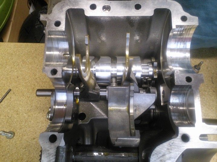

The third day I pulled the engine down, putting all the various pieces nicely stored on my shelf and those pesky bolts and small items clearly marked in my kiddies lunch bags.
After packing them up and a quick chat to Scott from Fitzgerald Motors, off they go for the 4.25 milling, Bearing Pinning and +1 Valve work

Today I tackled the fuel system. Pulled the fuel components with my nifty tool (thanks again to Ebay), cleaned the inside and outside of the fuel tank and bolted it back into the bike. Bought a Walbo Fuel Pump (#F10000137) from RSC a while back, with a 190 lph rating (not as much as the 255 lph Walbro’s, so a nice compromise for my new BB). Snag number 2 (2 in 2 days, I am on a roll). Well, a little more than a snag – the bendy fuel pump line on the pump would not budge, no matter what I did. After I took the clamp off, I could get it to move a few mm’s but that’s it. While I was pondering my next move, I was staring at the flange, and wouldn’t you know it, the fuel flange intake was hanging out more then it should. Snap – I recalled a service recall on this exact thing, and yep my flange range is 2 days in the recall zone. Now, I don’t have it in me to fight the new flange fight with the local dealership, so took the original method and plan tap it and put a barb adapter in. Parts on order + a new fuel pump line. Does give me time to scrub the fuel sender contacts

Today was pretty light but I did manage to weigh all my CP piston assemblies, and shipped the Destroyer Crank, PA weights + Carrillo info card off the Falicon for balancing. Plus I needed to get a new rear fender to create a custom cut fender to fit the 240 since the one I have does not fit. Ebay to the rescue and a steal at $60 – a few dings but in the section I plan to cut away, so perfect!
